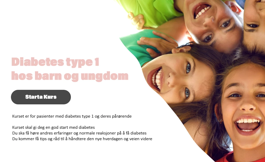

Remove autoplay button and place the clickable area elsewhere
Not sure if this is possible but maybe with some configuration in the published files.
To be able to change the background on first slide visible to the user at also change the play button is really usefull
But what if I would like to remove the button all together and make the user click the button I would like.
As seen in the example below I would like the user to click the black button reading "starta kurs"
Or, alternativ, alow the full area to be clickable to "activate" the course.
Could this be done by for eample edeting some sourcefiles in the export?

    mysk83Author
    Apr 25, 2023 6:54 AM UTC
    Thanks. I tried it and it kinda works 🙂 But it do not show the video that should play, or anything else 🙂
    But I will try working on it.
    mysk83Author
    Apr 25, 2023 7:58 AM UTC
    Tried it a bit more and worked perfectly. Thank you
