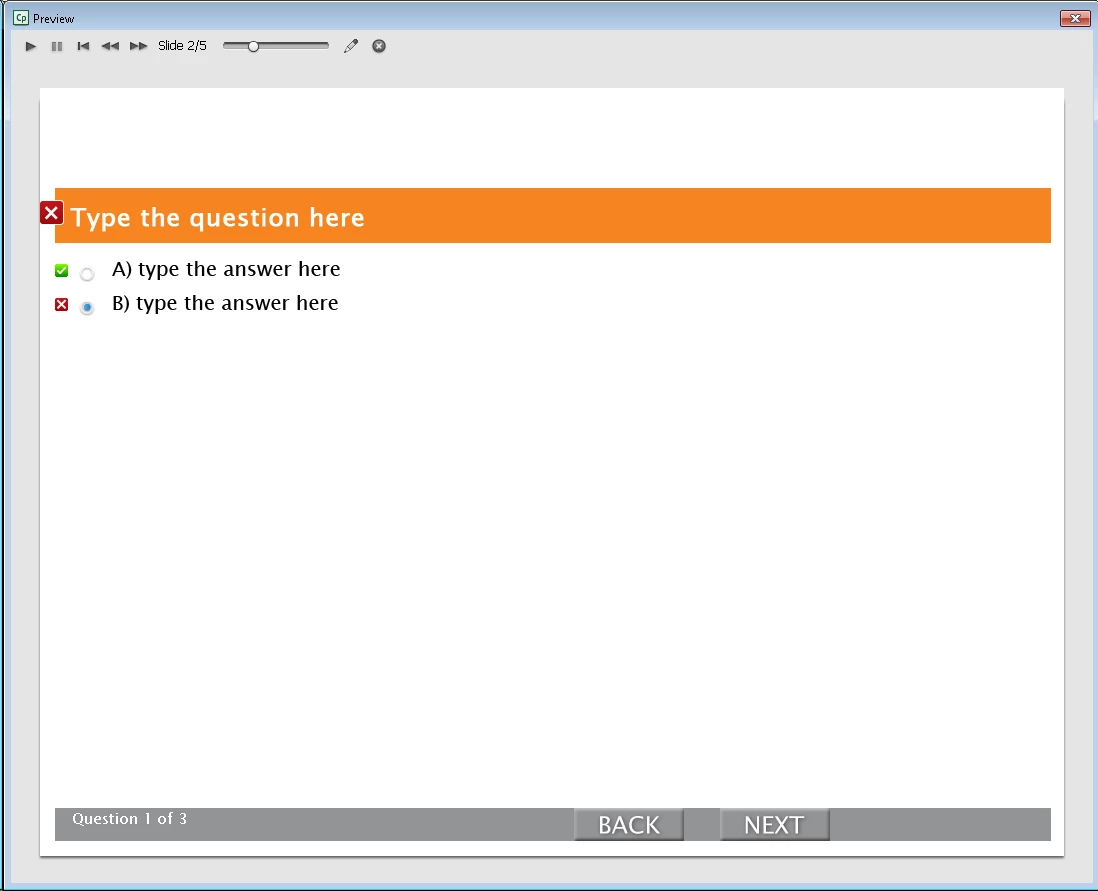

I am having some issues with Captivate 7. The main issue is the images during review. Correct/incorrect answers get a checkmark/cross before the answer and the question. I would like to change these images to different sizes and/or positions, or perhaps get rid of them all together and use the review area. But I don't know where to change them. These are the checkmarks and crosses I am referring to:

In the SWF output, Captivate does not offer any way to customise the position or appearance of these icons.  If you are using HTML5 output, you can try playing around with replacing the icon images, or modifying the CSS code that positions them in the final output.  But Captivate doesn't offer you any way to do this through the application interface itself.
The colour of the rollover effect on the answer options is also not configurable.
