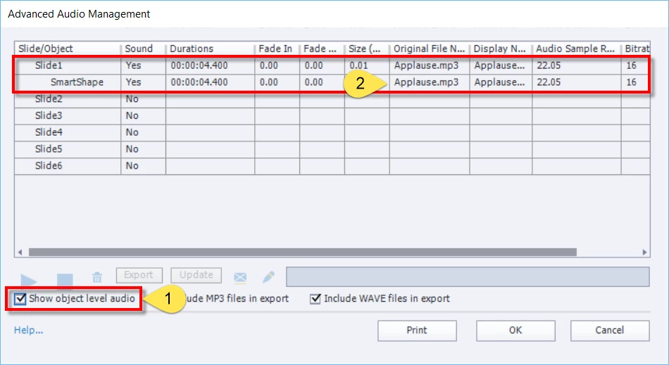

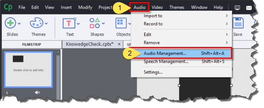

Captiv8r
Jan 29, 2016 6:20 PM UTC
Hi there
I see you have resolved your issue and that's great!
What we note about Captivate is that it's possible to attach audio to nearly anything. And it's not always easy to figure out where audio may be coming from once things like this occur.
Given what you posted, it would seem that you had audio assigned to an object that was being played simultaneously with slide audio.
One place to look for things like this is the Advanced Audio Management dialog. To see it, click Audio > Audio Management
And from the ensuing dialog, enable the option to Show object level audio.
These steps should be able to assist in determining where audio is coming from.
Cheers... Rick
warmstrong
Jan 29, 2016 10:10 PM UTC
I think I check that but not sure I had checked the show object level audio. I will surely look into it. Thanks for the assist.
