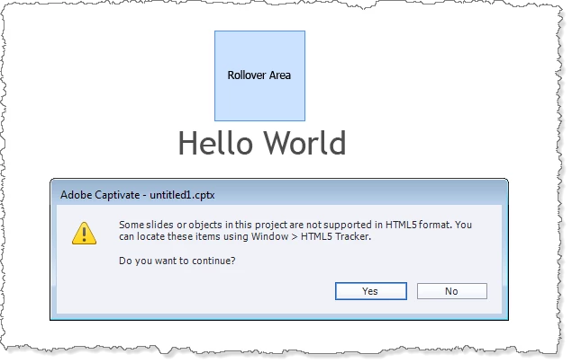

If you are never going to be delivering your e-learning from a touch screen, only mouse-driven desktops, that's one problem solved.
But Captivate basically thinks rollover objects are not supported for HTML5 output.  And it tells you so when you try to test the content in Edge Inspect as HTML5.
However, when you actually publish and play this content in an HTML5 browser on a desktop with mouse, the rollovers DO work.
So maybe you don't need to worry.

Use Click actions instead of rollover.  One click/tap event to make something appear, and another one to make it disappear again.  Create toggle actions if necessary.
