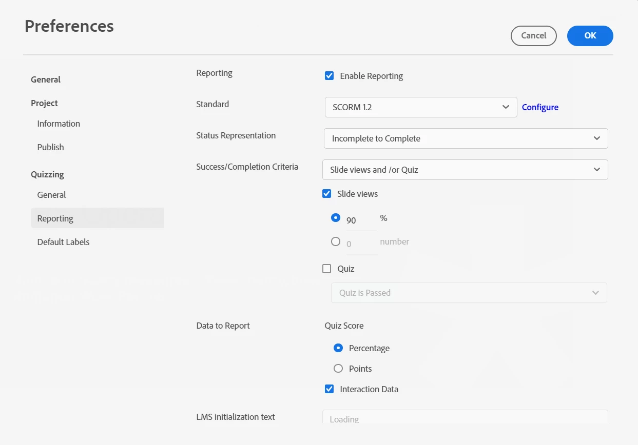

I am trying to create a SCORM 1.2 with Adobe Captivate 12.3.0.12.
This course is very simple, I only want to include 1 video in 1 slide. The video is 382 seconds long, for this I have set the preferences -> slide duration - 382 seconds.
Reporting, I have the current settings as attached screenshot.
When I uploded to the LMS system (SabaCloud) and checked, I watched the whole video and the course stayed as not evaluated.
Is there maybe an other option, to include some hidden button, or something that when is viewed, that is when the system would mark the course as completed?
Other question, under the reporting, the slide views percentage is based on how many seconds is the slide?
Can someone help me, how can I set this up, so the LMS mark it as completed?
Thanks a lot!

    I had the same issue with Docebo. We ended up changing the 'Exit Course' button to 'Run Javascript' and used "SCORM_CallLMSFinish();" and it ended up triggering completion correctly in the LMS.

    If it stayed "not evaluated" then something is wrong with SabaCloud. Did you enroll yourself? You can also test on SCORMCloud or any other LMS.
    The settings you provided should work. The only other thing I would recommend is to update to the latest version of Adobe Captivate (which is 12.5.x).
