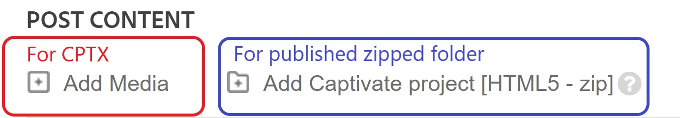

    In the portal you can upload two types:
    1. The cptx-file: for that purpose you need to use the Add Media button, same button you are using for uploading attachments like graphics to be embedded in your question, pdf... That button accepts also cptx-files and they will be included as a download link.
    2. The published folder in its first version (no SCO). It is compulsory in that case to have it zipped by Captivate, not manually. To upload that folder you use the Add Captivate project (HTML5 -zip). I agree that it is bit confusing.
