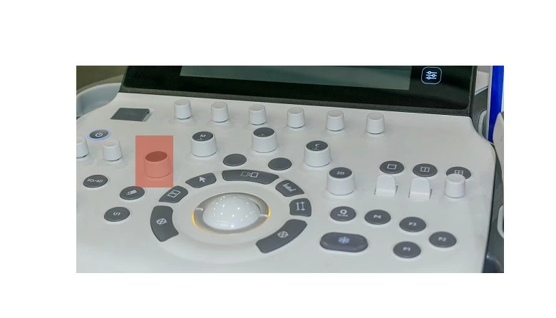

I am working in Captivate to create instructions for an ultrasound machine (knobs and switches).

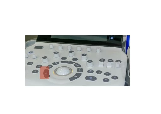

I want to put a button on an image (select which button does what). In a non-responsive project this is peanuts, in fluid-boxes mode, the hotspot always scales out-of-position.
I have tried the tips from Adobe but the hotspot/button keeps on scaling out of position: https://helpx.adobe.com/in/captivate/kb/issues-creating-hotspot-question-responsive-project.html
I have also tried the 'lock size & position / smartshape'...
Is there a way in Captivate to maintain the position of an overlay shape (for button/hotspot) to the image in the back? Same for drag&drop ...
thank you!

    The main reason for your problem is that a normal Fluid Box doesn't allow stacking of objects on top of each other. That is the reason for that hotspot link which you posted, and for banning click boxes. Only in a static fluid box will it be possible to stack objects, but I suppose you did read that in the hotspot link.
    There are a couple of possible workarounds if you are indeed persuaded to need a responsive project:
    1. Switch to Breakpoint Views workflow. I know that Adobe is not even mentioning it anywhere, but it is still possible to convert a responsive project with Fluid boxes to a Breakpoint Views project using the Project menu. The control is much better but it may take more time to have a working project. This older blog post explains some of the differences;
      http://blog.lilybiri.com/fluid-boxes-or-breakpoint-views
    2. If you are on the most recent version of CP2019, which is 11.5.5.553 (Windows), you may ignore that it is posssible to use a slide without fluid boxes in a Fluid Boxes responsive project. In that case you will set up the size/location of objects using the same Position Properties panel which you also have in a Breakpoint Views project. That may solve the issue as well. I have described this for another use case, interactivve video, which is also impossible in a normal Fluid Box.
      http://blog.lilybiri.com/fluid-boxes-and-interactive-video-position-properties-panel
