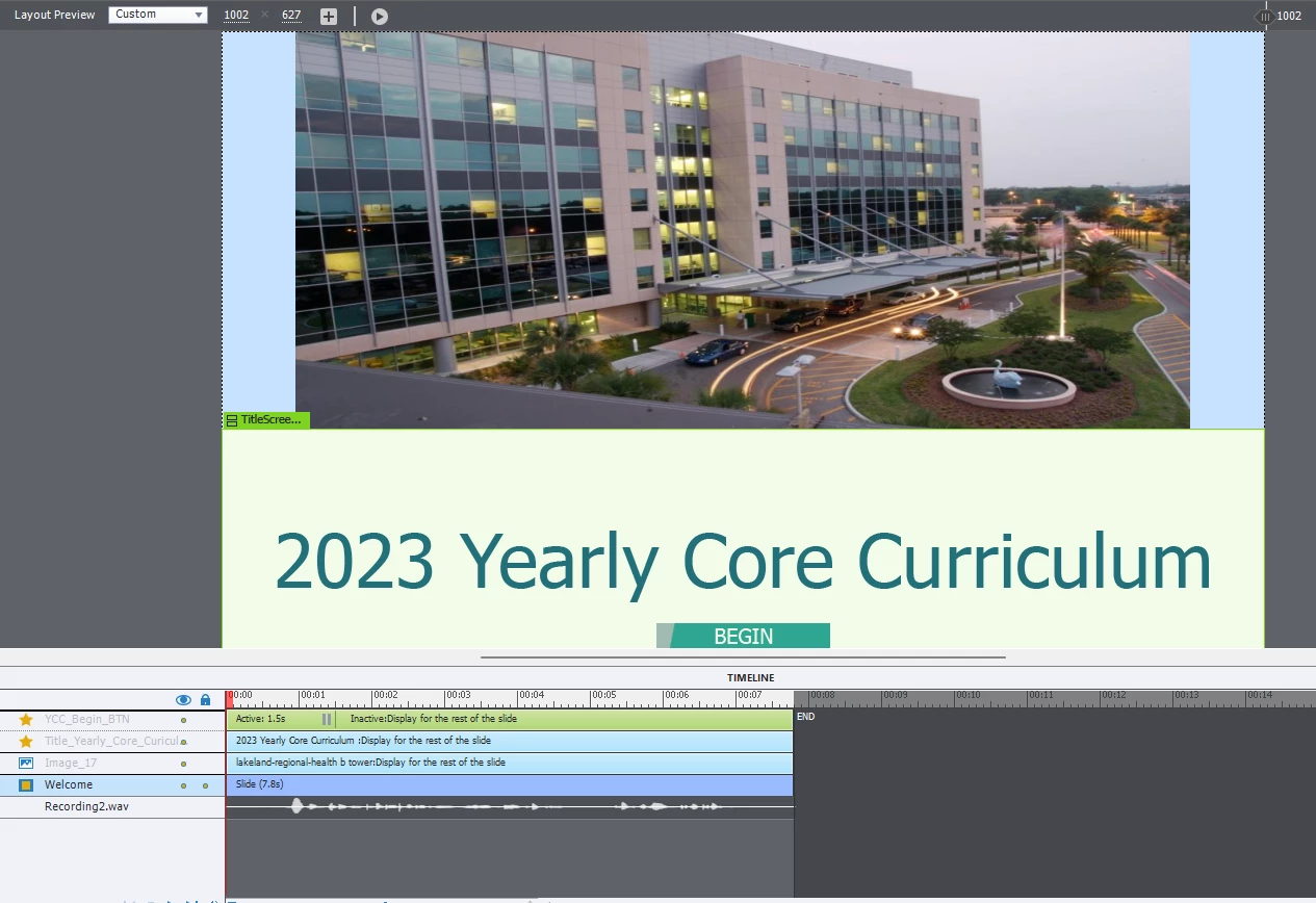

    Maybe post a screenshot of the Timeline of the first slide.

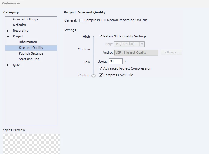

    How big is the output folder? You can check this in the panel Project Info, click the button Check next to Size Output (HTML). This question is due to your mentioning that you sometimes can view Next 5 slides, but have issues with viewing the full project.

    The first slide is not very heavy, just a picture, short audio clip, and a continue button. Timeline pic below:

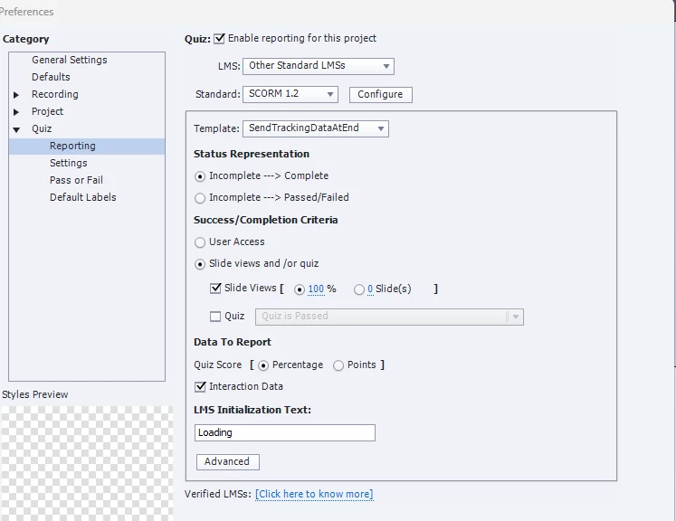

    I want the project to allow the learners to complete parts and then have it save in the case that they are unable to complete the entire course in one sitting. here is a picture of the reporting information that is configured:

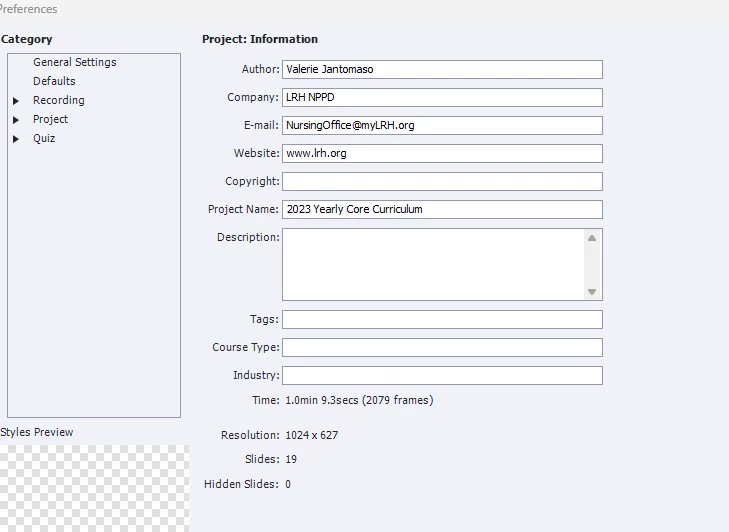

    I do not see where to check the project size, the picture below is what I get when I look at the Project info panel

    here, I clicked on project and revealed the Size and Quality
