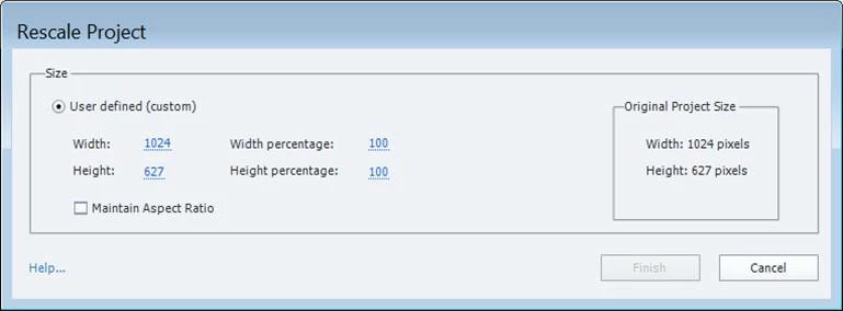

    Info from Adobe Captivate:
    You can rescale your responsive projects up to 4K from menu bar option “Modify” > “Rescale Project”. After this publish your project again and view it on larger screen size to see the change.

    Apr 13, 2021 9:54 PM UTC
    DeiterVR, I can rescale to the client's required desktop resolution of 1600x900 in a blank project, no problem, but, as soon as I convert to Breakpoint Mode (5 breakpoints required by client), the maximum width for Desktop breakpoint is 1280, and I can't find any way around it.  I can't "re-scale" again, as it is greyed out in the pulldown.  I think I'm stuck.   Sigh.
