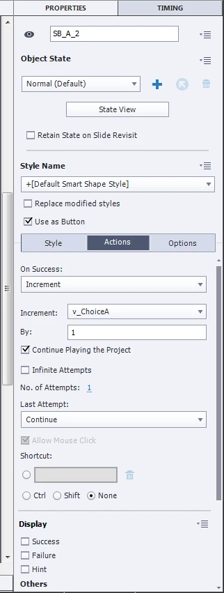

    For each question slide, I made two Interactive Buttons. In Properties>Actions I put:
    On Success: Increment
    Increment: c_ChoiceA
    By: 1
    I set the number of attempts to: 1
    Last attempt: Continue

    Correction: The increment command was not written in Advanced Actions, rather I simply put it in Properties, like this:
