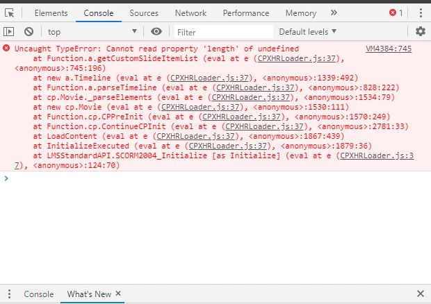

Have you had any luck getting this issue resolved? I'm running into a similar issue with Captivate 11.5
Re-launching any of my published SCORM packages from the LMS results in a hanging loading screen. I can't even test whether or not the bookmarking works because the course never loads after the first attempt. Here's what I got out of the console:
