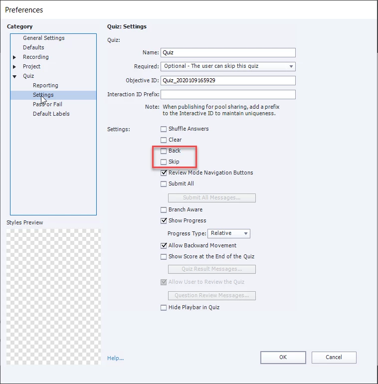

    Oct 12, 2020 11:18 AM UTC
    Paul - I have tried adding the back button and that's no really suitable for what I want to achieve as it doesn't solve the issue of not being able to re-submit answers after leaving questions slides.

    Oct 9, 2020 9:02 PM UTC
    The quickest and easiest solution based on your criteria is to add Back and Skip buttons to all your question slides. Open your Preferences window and select the options for Back and Skip and it should automatically place these buttons based on your Master slide layout on all your question slides.
