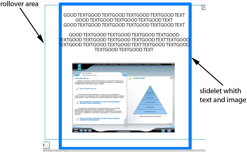

I need insert Into a slidelet text caption with image. I want't use rollover image and rollover caption separately. Can i use it into rollover slidelet together.
How can i do it?
Try this:
I have a rollover in the slide. Rollover area very big (half of slide size). Slidelet location over the rollover area. Into slidelet i insert the big image, and this image location is over the rollover area. After publish, then mouse over this image i see blink image.
How can i fix this problem?

    I've looked at your CPTX file.
    I think your issue is that you have the rollover area for the slidelet positioned directly underneath the slidelet, and you also have Show Runtime Border switched on.
    It looks to me like the issue you have with the flickering is due to Captivate checking on each frame to see if the rollover area is currently being hit by the mouse and responding accordingly.
    When you mouseover the slidelet rollover area the slidelet appears, but then as soon as your mouse touches the image or the transparent text caption area inside the slidelet it registers as a loss of focus for the rollover area and the slidelet disappears.  Additionally, because Show Runtime Border is switched on, when you mouse over the rollover area, the appearance of the extra border width changes the physical size of the rollover area.  So there is a point at which things flicker due to these changes.
    Try turning off Show Runtime Border, and move your rollover area out from underneath the slidelet.  Slidelets are intended to be similar but more powerful than Rollover Captions and Rollover Images.  You can have almost anything inside a slidelet.  Even animations or video.
    But the rollover area for Rollover Captions and Rollover Images happens to be on top of the caption or image that appears. In slidelets the rollover area is UNDERNEATH the slidelet.
    My belief is that you should have the rollover area off to the side somewhere so that you can mouse over it and mouse out without hitting the slidelet.

    I do not really understand your question: perhaps you could insert images (use the still camera icon to do that)? You want something to happen on rollover, should the text caption and the image appear at the same time? Since you need 2 objects, you will have to use a rollover slidelet. You can set the duration of that slidelet (has its own timeline) and eventually time the two objects to appear at a different moment.

    i need, then my mouse over one rollover area show text and image appear at the same time. But image and text maybe over the rollover area. When this happens the image and text start flickering and blink
    like this
