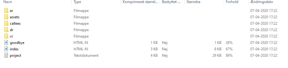

Best way is to upload to a webserver. I gave you a link to thz site of amzon.aws. Then you send the URL, which will look like this one (it is on my domain):
http://www.lilybiri.com/published/PlayPause_Scal/index.html
It is the index.html file which will launch the course.
In mylast answer gave a lesser alternative: send the zipped folder (use Dropbox, or WeTransfer). Tell them to unzip the folder and launch the index.html file. Whether this locial viewing (will use localhost) will be fully functional depends on the course.

Apr 7, 2020 7:02 PM UTC
Probably you didn't create a SCO, but a normal zipped package. Can you show a screenshot of the content of the package?
You don't need a website, just a webserver. That is why I mentioned amazon.aws
https://aws.amazon.com/
You would also install a webserver on your system, but that may be too complicated for you?
