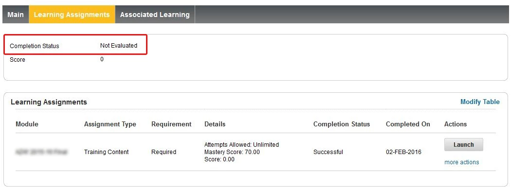

Then, I tested by play until end of the course include finished the quiz, the result that I've found that is completion status still be "Not Evaluated" like below image.
I would like to change completion status to be "Successful".

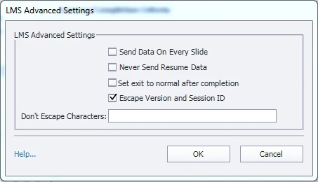

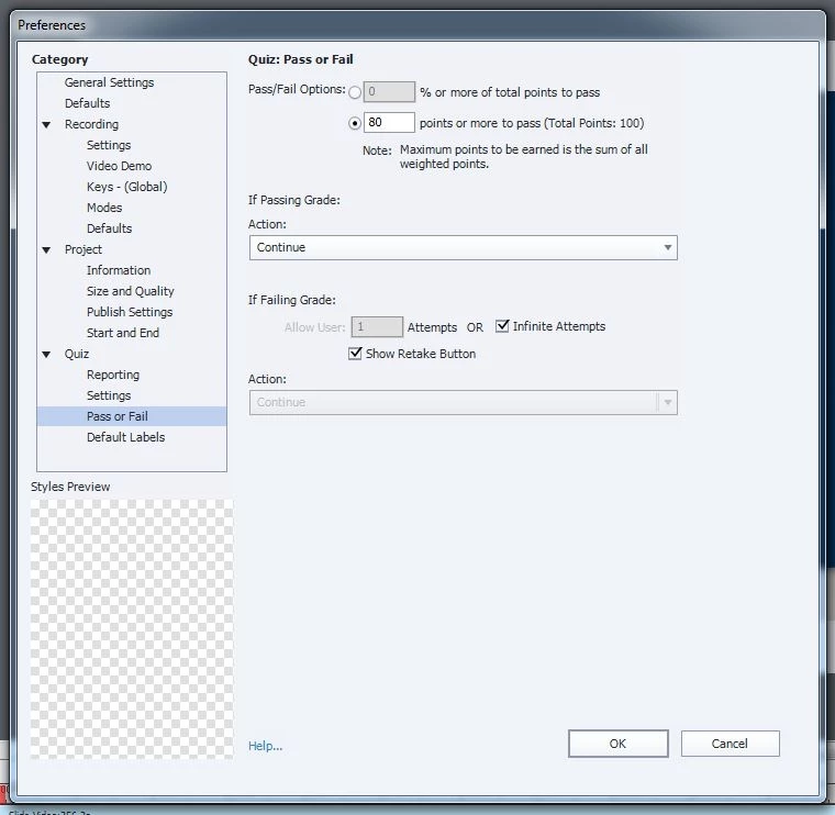

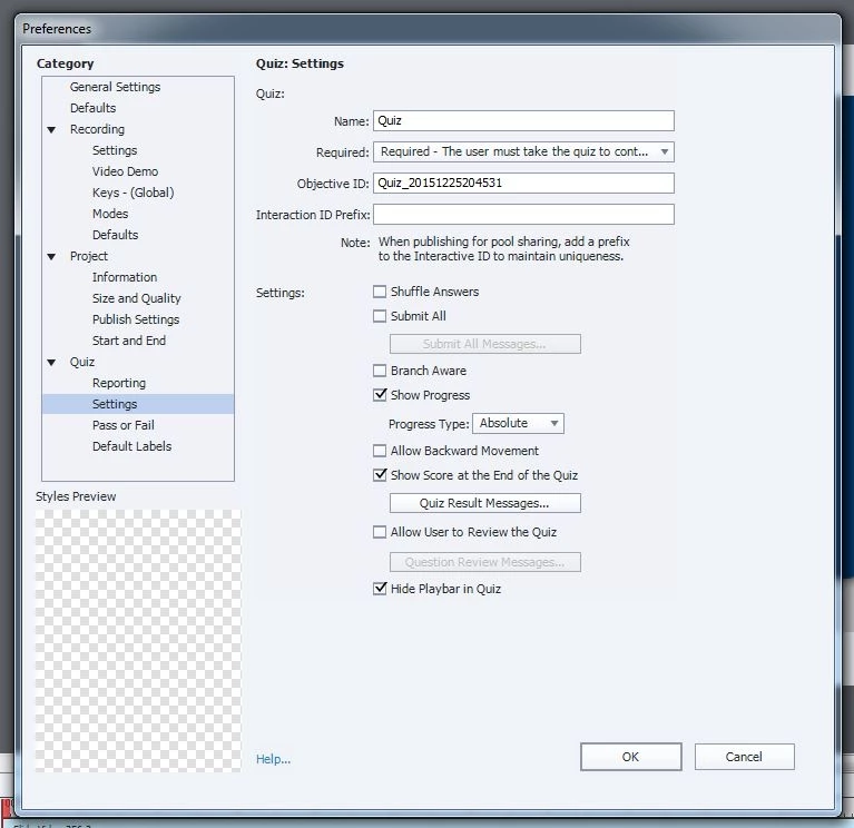

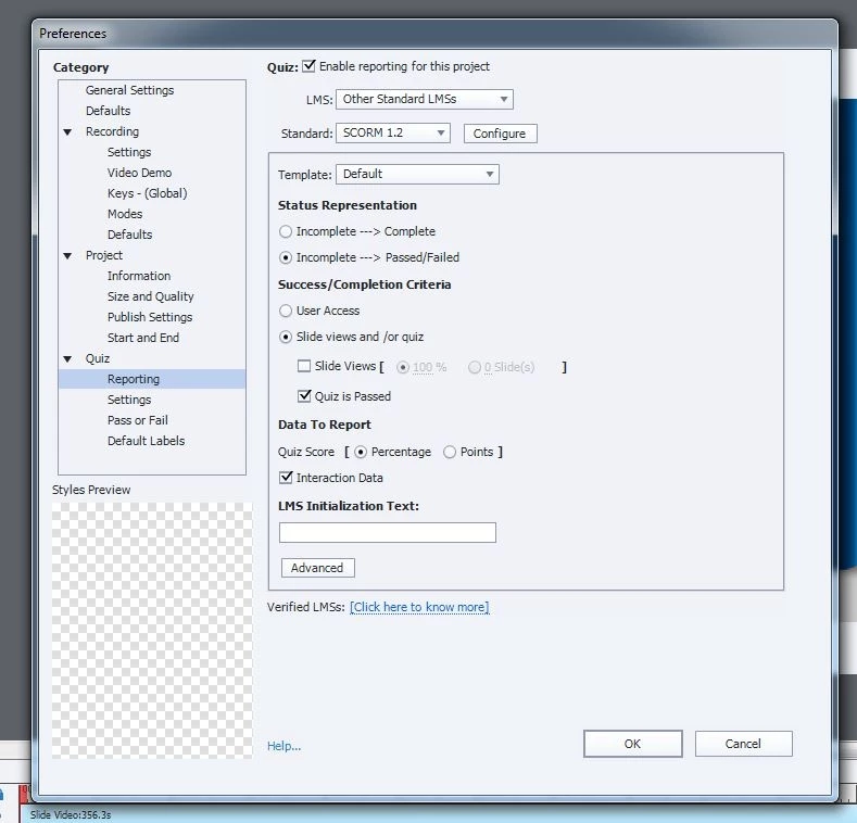

All below images are my setting in the program for your reference.

Correct answer TLCMediaDesign
Try  status representation:
incomplete-- > complete
instead of:
incomplete --> passed/failed

Thank you for your response.
I have tried with change status representation as your suggestion.
In first time, The course is not working.
But after I tried to exported many times and uploaded to SABA Completion status in their is changed to "Successful".
I can say that suggestion from you is important part of Correct Answer for this issue.
