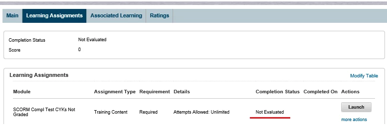

Facing an issue in Saba 7. The Captivate build courses are not getting Completed in Saba main page. I have tested with Captivate 6, 8 and 9 - it's the same everywhere. Saba 7 not showing 'Completed' status (Completion Status column beside the Launch button) with courses build in Captivate - it remains 'Not Evaluated'.

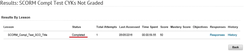

Though 'more actions' and then 'View Results by Lesson' shows that the status is 'Completed' with Total attempts and Last Accessed.
This means though the course gets completed, it's not rolling up the status.

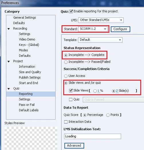

No quiz, no score - just 5 pages and course should be completed when 2 slides are visited. I have used the below settings:
Anything wrong? Any patch/code/settings need to be introduced?
