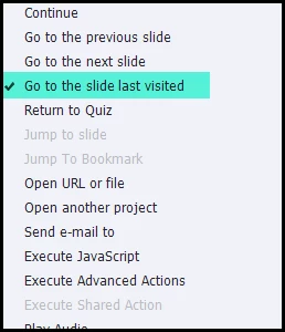

    Stagprime2687219
    Sep 28, 2021 1:27 PM UTC
    Are you trying to do this...   or something slightly different?
    Sep 28, 2021 1:30 PM UTC
    Thank you for ur reply. No because the learner can visit previous slides in the course and should be able to return then to the test. So the "last visited" slide wouldnt be the slide in the test - it might be another slide in the course. Thats why i want to save the slide in a variable.
    kind regards
    Stagprime2687219
    Sep 28, 2021 1:44 PM UTC
    Ah - so you only want to assign the current slide to your variable only once the learner has reached your test so that they can go back to other slides and review and return to the last test slide they made it to? That would make a bit more sense.
    I had the impression that your variable was constantly being updated to the current slide so I was a little confused about the use case.
    If that is not the case - then I am still confused about what is supposed to happen.
