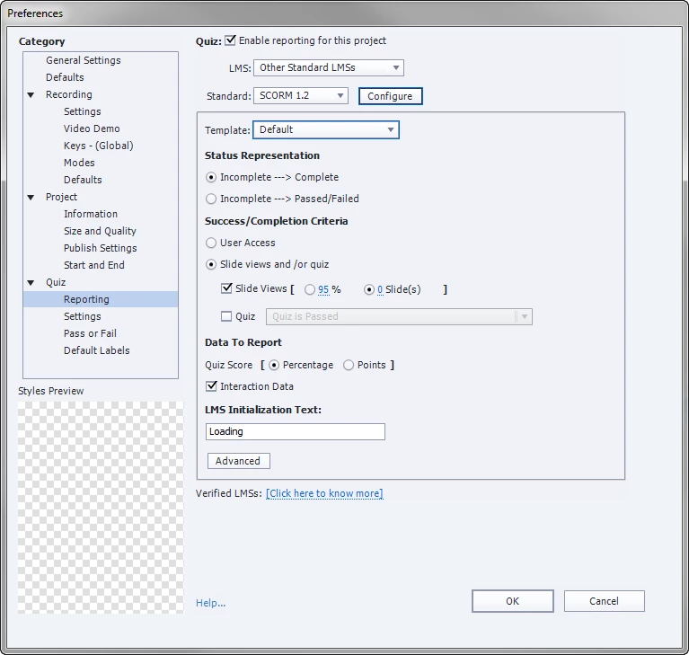

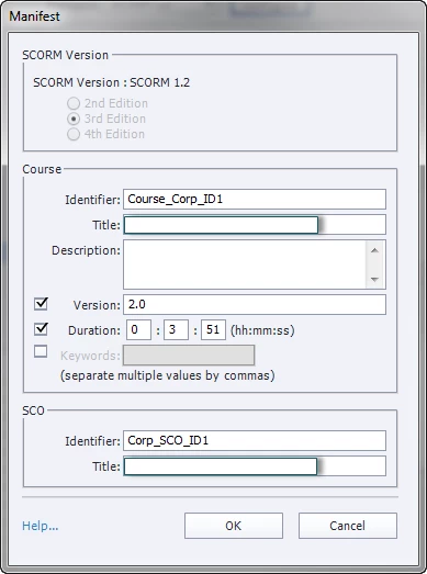

I'm in need of some help.  I created a course and published into a SCORM zip but when I load the zip file into CornerStone LMS the duration is not being sent over.  Here are some screenshots of my settings.

If you fill in the details in the Manifest dialog for Course and SCO, what then?
tomv8116241
February 23, 2018
Hi RodWard,
Sorry the details were filled out I just blocked on the screenshot.
RodWard
February 24, 2018
OK.  Understood.
With regard to that Duration field, I have heard that you need to obey the format using two digits (as shown beside it) not just one.
So, if the duration was 1 hour 5 minutes and 3 seconds, you would need to enter it as 01:05:03, not as 1:5:3
Get the idea?
Some LMSs are very picky about little details.  Maybe that's the case here.
