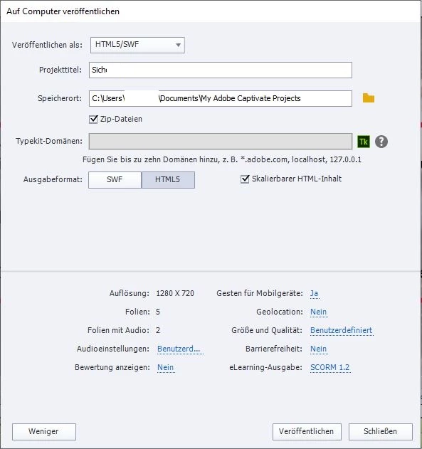

Just an idea.  Try turning off HTML Scaling in the Publish dialog settings and see whether that makes any difference to the performance in IE11.  I personally NEVER use that setting and I have had no issues with performance in IE11 with the corporate clients I have that are still using it.

Can you confirm the version of the software and the operating system you are using?
Also, can you share screenshots of the export settings?
pg2702blnAuthor
Feb 6, 2020 7:27 AM UTC
my current version of captivte is 11.5.1. an update will follow in the next days by our IT.
Furthermore here is the desired screenshot. Since Captivate runs in German, the picture is also in German. I hope you understand it anyway.
