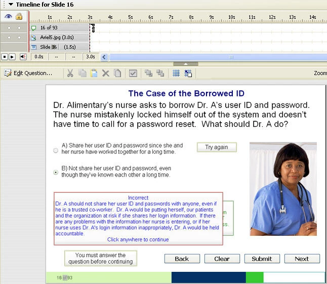

FYI, here are screen prints of one of the slides with the problem:
        --Jan

What is the Try Again button on this slide?  Is this a static widget button?
