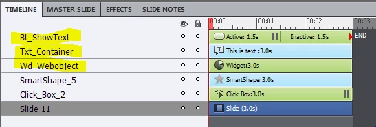

Here is an example from what Rick suggests you to look for:
In this timeline the upper most object is a button: you see a double line at 1.5 secs, which is where it is pausing. Select it and you'll see that time also in the Timing accordion of the Properties panel of that button.
The Click box just at the bottom has also a pausing point: it is at the end of its timeline, because a click box is by default invisible, contrary to the button that is also visible but inactive after the pausing.
