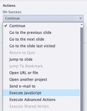

So now, after these general topics, to your main question. How to check the score progress and how to navigate to some content or congratulations slide (or wherever you want to send your student after reaching the pass score) and effectively end the quiz. I haven't tested this myself so far, it should logically work, though.
For random questions slide there is in the Quiz panel under Actions / On Success the possibility to either Execute Javascript of Execute Advanced Actions. On Success is, so I guess, the event when a corresponding question has just been aswered correctly (if i'm not correct here, please, captivate experts, correct me).
When you test here if a pass score has already been reached (cpQuizInfoPointsscored), then a Jump to Slide could be conditionally triggered, to send the student to wherever you want to (maybe to a result slide). In case the pass score isn't reached so far, you trigger a Continue command.
So much for the raw logical structure, it depends now very much, what you prefer. As Lilibiri has already asked, do you want to use Advanced Actions or Javascript? Both is possible.
