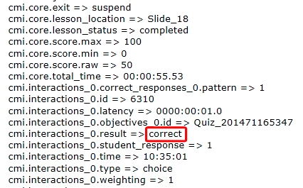

This is what I'm seeing on my LMS report (this is an example for one question)
As you can see the result of the question is showing as "correct", but it was actually answered incorrectly. It's a multiple choice question using click boxes. For the correct clickbox I've got these settings:
The wrong clickboxes have these settings:
I've also tried unticking the "Include in quiz" box, and only having the "Add to total" box unticked, but my LMS still tells me it was answered correctly when answered incorrectly.
Any thoughts on why this is happening?
