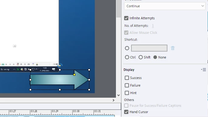

Hi
The buttons I have created link perfectly and jump to slides on Friday but by today, none of the them are working.  This keeps happening and I have no idea why.

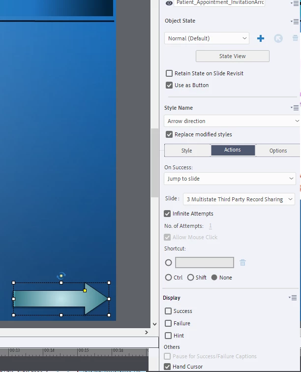

I created my own shape and clicked 'use as button'.  It should then jump to a slide.
That is all it needs to do.

    You have a custom style for the forward button, probably within your custom theme. Was that custom theme created or upgraded to the present version you are using? I am still worried about the fact that you can use only 'Save as' for the project. Did you ever clean the Preferences in Captivate?
    You do use a simple action for that button, which has an instance on each slide (my suspicion). Are those actions lost when you save? Or is it a problem with the Advanced action (which I didn't see yet)?
    You suspect a problem with the multiple names for the buttons, is there a reason why you opted for an instance on each slide instead of using a shape button on the master slide(s)? Do you need a lot of Next buttons which do not navigate to the next slide?

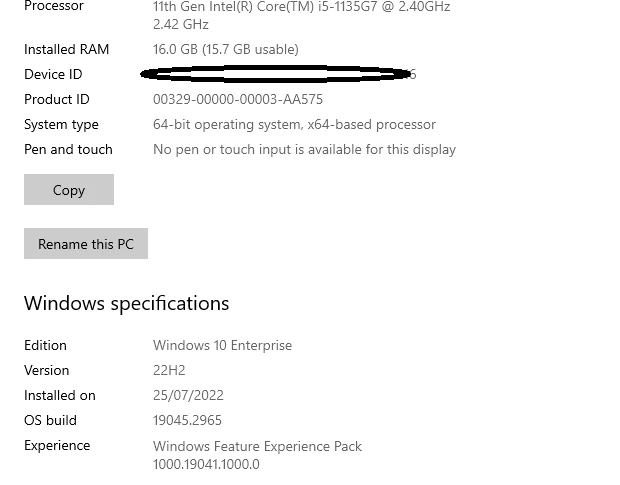

    Attached is the OS information.
