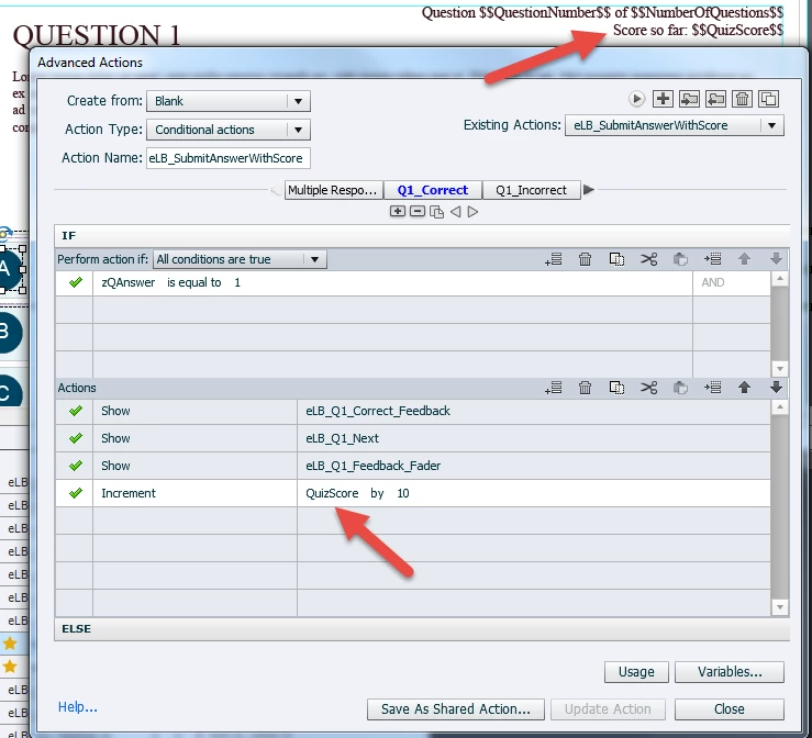

    Here's the Advanced Action I used to create the Shared Action. The only thing I've added is the last line on this tab, to increment QuizScore by 10.

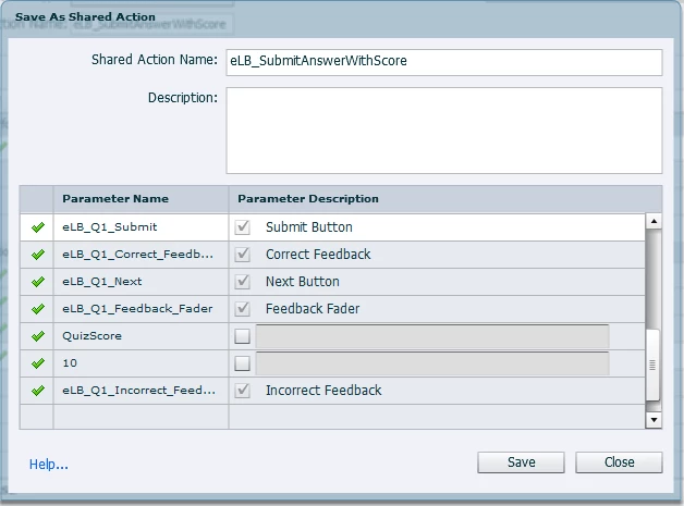

    When I save this as a Shared Action, I've tried indicating that QuizScore is a required parameter, and I've also tried without including it as a parameter - neither seem to work.

    Becky, I suppose this is an eLB action? Can you show me the total action, using the Preview button, which is the first button in the control panel at the top right (arrow).  Sequence is very important in actions, want to see what happens before and after this decision.
    Can you also tell which event is triggering this action? You can check the Advanced Interaction panel - F9 (if it is an advanced action) or the Usage button in the Library for shared actions.
    You are not on CP2017, that is clear from the AA dialog box. Neither the variable nor the literal should be parameters, if you always want to add 10 points to the same variable.
