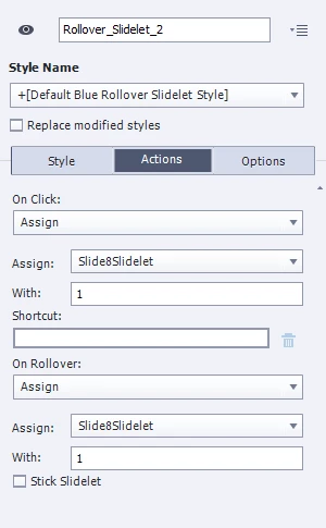

For the Rollover event (On Rollover in the Actions Tab of the Properties panel of the slidelet), use this action:
            Show Slide8Back
Maybe it is better not to use a Simple action here, because that will release the play head, but a one-line standard advanced action will do the trick.

Which event is triggering that conditional action?  Do you want to show a slidelet or only to use the event 'rollover' of the slidelet area?  And that rollover should show a button the first time and hide the button when rolling over the second time? There is no 'roll-out' event, you are not able to hide the button by rolling away from the slidelet area.
Rolling over the slidelet itself has no sense, it has no events. The normal behavior of the slidelet area is to show a slidelet, which can have multiple objects on it like on a slide. But the slidelet area can also be used because it has two events: On Click (same like a button or a click box) and On Rollover.

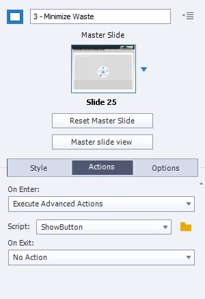

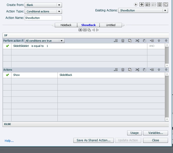

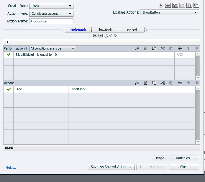

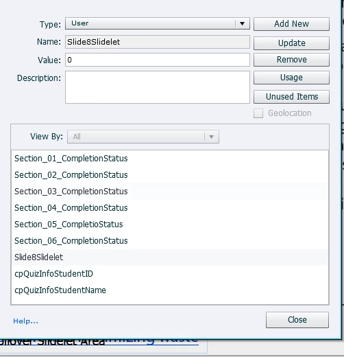

The advanced action is currently set to execute on enter of the slide the slidelet is on.  The variable is on the Rollover Slidelet Area.
Yes, I want the slidelet to show and for the back button to appear as soon as they rollover the the Rollover Slidelet Area and stay on the page for the rest of the timeline.

On Enter has no sense whatsoever for that conditional action. It can have sense to use an advanced (or shared) action On Enter for the slide, just to hide that Back button, could even be done with a simple action. A variable is never 'on' something, it is just a container that can store a value. Do I understand it is this scenario that you want:
  • When entering the slide, the Back button, labeled Slide8Back is hidden (do you need this on many slides?)
  • User can roll over an area (slidelet area) and a slidelet appears for the time set up for that slidelet
  • At the same time on Rollover the Back button has to appear
When you confirm, will explain what you need, no variable needed at all, not even a conditional action.
