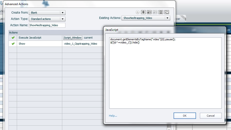

Nov 5, 2019 7:32 AM UTC
Hey that worked out just great! Amazing. Thank you so much.
Now what I try to do is to close the current video playing and show another one by naming all videos "video_1_anothervideo"
The use the action "show" "anothervideo".
This solution do not work for me?
See screenshots: )
