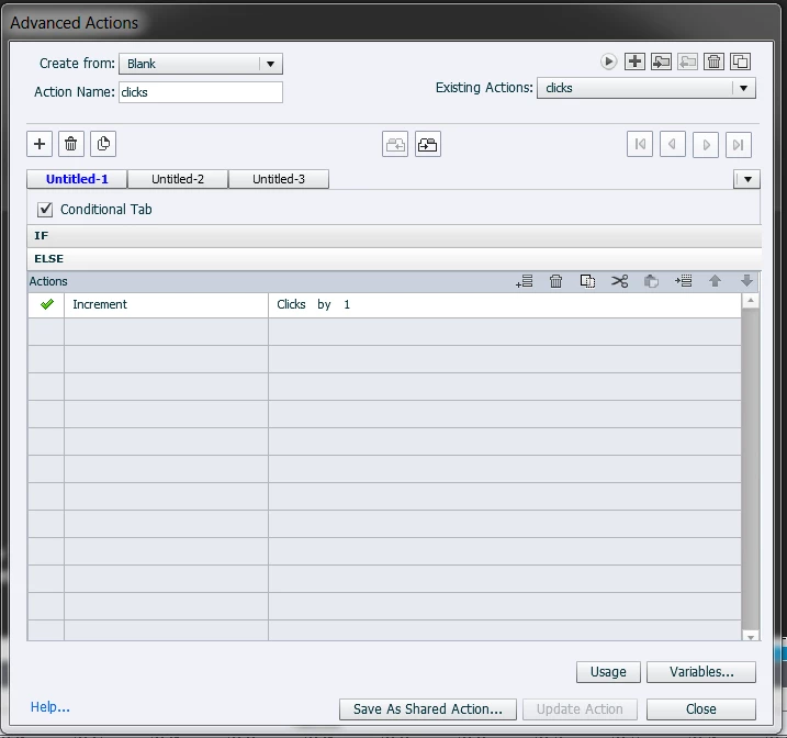

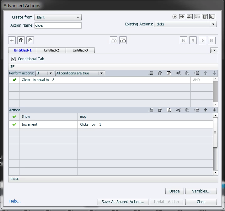

It is not a responsive project. I feel more comfortable using advanced actions. Im not sure how to increment the variable when it is clicked though.
lashondrac51319316
December 14, 2017
Okay, I figured it out! I set the 'clicks' variable to 1 and then did this.
