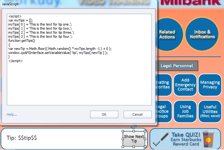

    justinm53961168
    May 5, 2016
    hey TLCMedia...thanks for your help. I've done as instructed but can't seem to get it to work.
    This is the code I have:
    <script>
    var myTips = [];
    myTips[ 0 ] = 'This is the text for tip one.';
    myTips[ 1 ] = 'This is the text for tip two.';
    myTips[ 2 ] = 'This is the text for tip three.';
    myTips[ 3 ] = 'This is the text for tip four.';
    function getTips()
    var newTip = Math.floor(( Math.random() * myTips.length -1 ) + 0 );
    window.cpAPIInterface.setVariableValue( 'tip', myTips[ newTip ] );
    </script>
    here is a screenshot:
    TLCMediaDesign
    TLCMediaDesignCorrect answer
    May 5, 2016
    As I said, for the script to work it had to be placed in the head of the html page, not the JS window.
    I answered the other thread with the code to make it work in the JS window.
    My thought was that there would be a ton of text and the JS window is very small.
