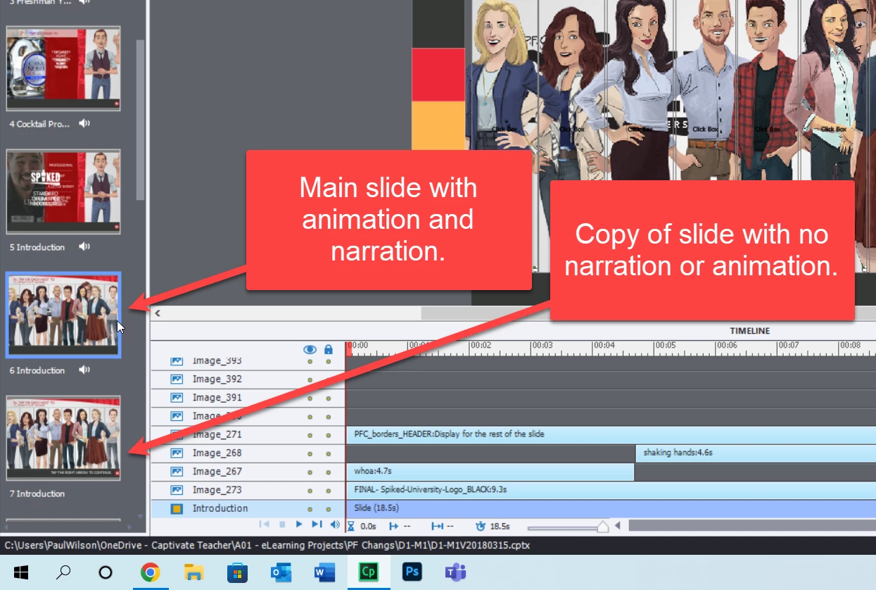

    Personally, the easiest way to deal with this is to have two versions of that main slide. The first is where learners might see all the animation and hear a full introduction narration. When users click on the "return to main" option to make another selection (my example below was clicking on characters to hear from them), they return to a duplicate version with no animation or narration. Closed captions will work on your initial slide, and it's doubtful your learners will realize they are not returning to the same slide.
