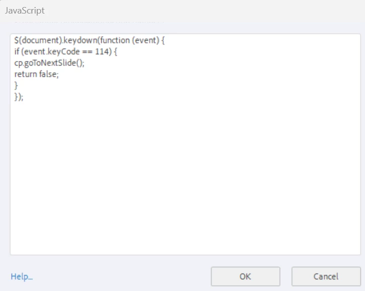

    Something like this would require a JavaScript solution.
    Here is a thought... give it a try and see if it helps.
    Use the  onEnter  action for your slide to  Execute JavaScript
    In the script window...
    // F12 Goto Next Slide but don't open dev tools
    $(document).keydown(function (event) {
        if (event.keyCode == 123) {
           cp.goToNextSlide();
           return false;
    The keyCode for the F12 button is 123
    F6 is 117
    Tab is 9
    Basically we have replaced the default action with our own.
    You would need to craft the actual actions you want performed in terms of JavaScript.
    Hopefully this works for you.

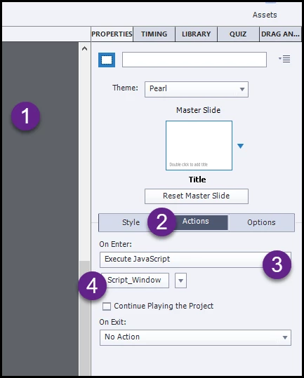

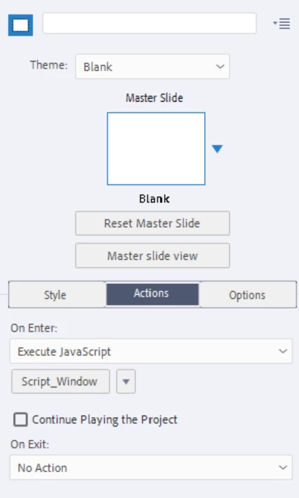

    If you are seeing  "On Success"  then you are looking at the choice when a button is selected.
    Click on the space outside of your working stage so that the entire slide is reflected in the Properties Panel. Then you should see the  "On Enter"  dropdown.
    The code I provided should take you to the next slide in your project - if there is one - and not open the dev tools.
