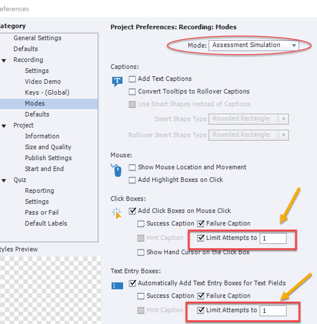

Lilybiri
April 23, 2017
Was this created using the Record Software simulation, Assessment Mode? For some weird reason the number of attempts is set to Infinite in that case. For that reason, whenever I install Captivate (or a patch), one of the changes I will make to the Preferences, is to reduce that number of attempts to 1 or 2, before capturing any simulation assessment:
This will have no effect on existing assessment simulations however. And I don't know about a way to apply the change from Infinite to a limited number to all click boxes and text entry boxes inserted during an assessment simulation. Easiest work flow (for me) is to open the Advanced Interaction panel, which is dynamically linked to the Properties panel, and select one by one each scored item to edit the number of attempts. Long time ago this was possible in the Advanced Interaction panel but that useful feature was taken away in CP5.
April 24, 2017
Thank you so much for this detailed explanation. I will change these default settings. This makes much more sense!
