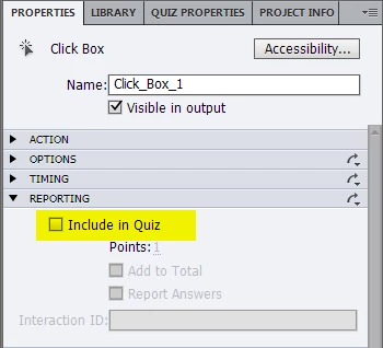

    You need to select that click box on the Simulation slide and then look into the properties of that click box and check whether that click box is added in the quiz or not (under reporting). You can uncheck that option to exclude that from the quiz.
    You can also check whether any other object is added in the quiz or not by checking 'advanced interactions' (Window > advanced interaction or F9).

    Maybe I don't understand your question well. But for click boxes and other interactive objects, only the Properties panel is available, not the Quiz Properties panel which is only relevant for Question slides. In the Properties panel you have the Reporting accordion where you can exclude the objects from adding a score to the Total score. Sorry if this is not what you want, but I'm answering based on your terminology '... everything in Quiz Properties is Greyed out...'.
