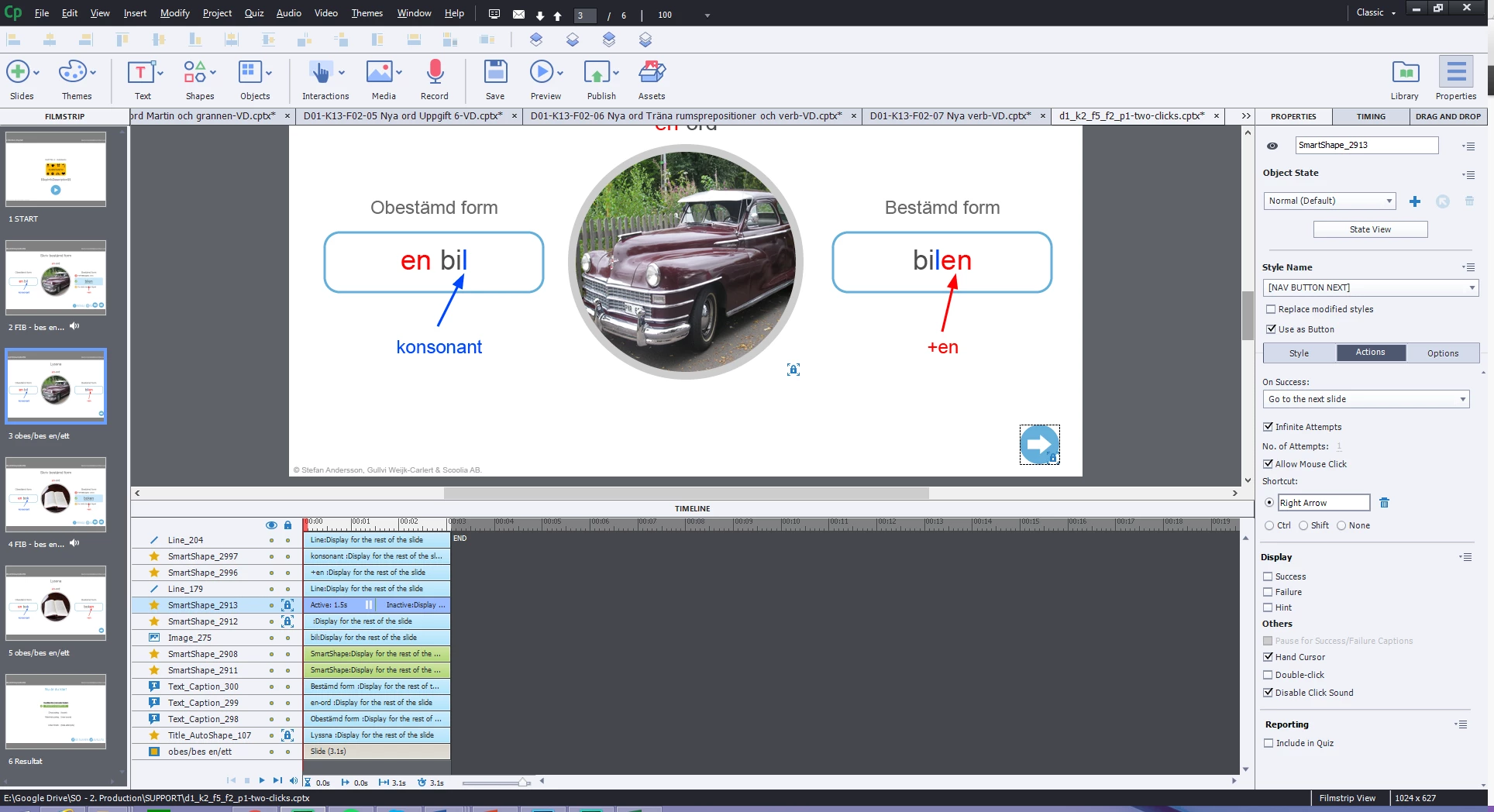

November 24, 2015
This is probably due to the pauses of the buttons, could you post a screenshot of the timeline please?
swedanAuthor
November 24, 2015
Here it is! The whole slide.
Lilybiri
November 24, 2015
This slide has only one button that is pausing, the next button. Shapes 2908 and 2911 (why not label them?) will probably trigger the audio clips. How do you trigger them: with a simple action or with an advanced action? May I suggest to give both shape buttons a pausing point, either at the same moment as the Next button or bit earlier, but they should have the same pausing time. You can trigger the audio clip with a simple action, but have to uncheck the option 'Continue Playing the Project'. In that set up the playhead will stop at 1.5secs from the beginning of the slide, and remain at that frame until the user decides to click on the Next button to go to the next slide.
