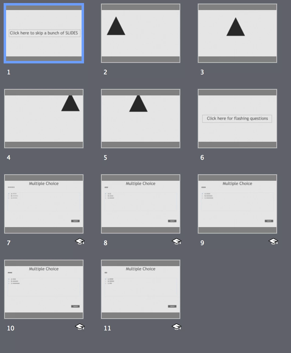

I am running into something weird.
I am creating a lesson where the user will select the group to which they belong, one of ten groups. This will set a variable with a value of the group id.
I have some slides and some knowledge-checks that unique to each group.
I have some advanced actions running on enter  that checks the group of the user, if the slide is not meant for the user's group, captivate is issued the command to go to the next slide.
When going through regular content slides, when a user comes to a section of slide not meant for them, the content area is blank for a fraction of a second and you can see the playbar advancing rapidly through those slides. Once the user hits a slide they are supposed to see, content shows up and everything works great, as expected.
BUT once I add in knowledge-check slides things go wonky.
The scripts and navigation still work fine, a user will rapidly progress through the slides until they reach a slide they are supposed to see. What is different it that the users get a quick flash (one frame?) of of each of the knowledge-check slide contents as they are moving rapidly through the slides they are supposed to skip.
Has anyone experienced this and come up with a solution?
I have tried to add some javascript to change the CSS to hide they question elements, but my CSS changes seem to get overridden by the Captivate player.
Thanks!

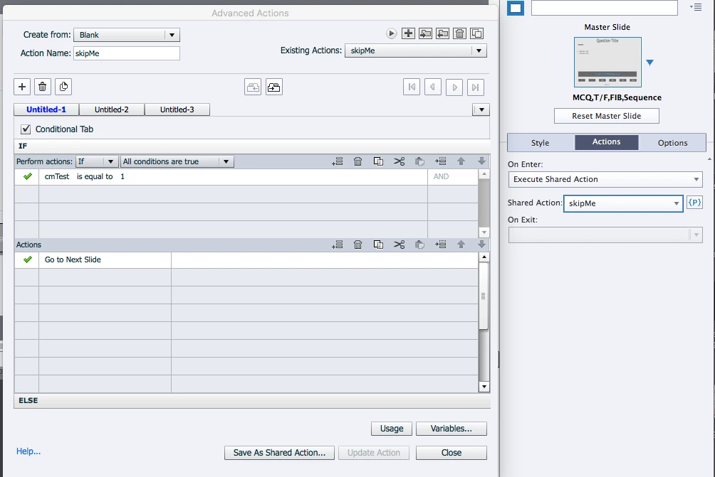

I think there something going on with your advanced actions - they are triggering when you enter the slide.  Could you post a shot of your advanced actions?
chrismay_at_delta6226261
September 4, 2018
The advanced actions are very simple. Not sure what could be wrong, but here they are!
Lilybiri
September 4, 2018
Please, especially when posting a conditional action, use the Preview screen, so that all decisions and the ELSE parts are visible. The Preview button is the first button in the op right control panel (arrow). All functionality of the Advanced Actions dialog box are explained in:
Advanced Actions Dialog box in Captivate 2017 - Captivate blog
You show that the shared action is used, what did you define as parameter, the variable cmtest?
August 27, 2018
The player progresses linearly through every slide.
The action on each on entry is basic: if userGroup does not equal 2 then next slide.
I am trying to use this method, because it is so much faster to develop rather than keeping track of all that branching for 10 different groups. It becomes overwhelming when you have some slides that all groups need to see, some slides only some groups need to see, and some slides that are unique to each group. If something is not working with my method, all you have to do is check the action on the slide that is showing/hiding incorrectly.
August 27, 2018
Here is a video of whats going on:
And here is a screen shot of the slides in the project:
