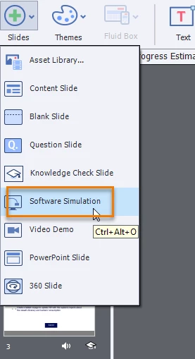

Nassia K.
Nassia K.Author
Jul 26, 2021 3:17 PM UTC
This is the Software Simulation option
