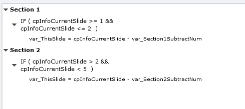

March 27, 2017
That is great. Thank you so much for that Rod.
I created a test project with 4 slides (2 sections with 2 slides each)
I used the variables that you suggested:
  • A separate variable to store the number of slides in each section.  E.g. var_Section1NumSlides, var_Section2NumSlides.
  • A separate variable to store a number for each section that when subtracted from CpInfoCurrentSlide would show the correct slide number for that section. E.g. var_Section1SubtractNum, var_Section2SubtractNum.
  • A value that will store the calculated value that gets the number to be displayed for the current slide.  E.g. var_ThisSlide (See below.)
and created an Advanced Action with several decisions
Of course, for the first section in this case there is no need for the above since the 1st and 2nd slides of the section are the actual 1st and 2nd slide of the whole, but the idea is clear.
Thank you once again!
Lilybiri
March 27, 2017
Hmmm, why a combination of conditions?
First condition could simply have been:
IF cpInfoCurrentSlide is less or equal to 2
That variable has an index that starts with 1, can never be less than 1.
Second condition:
IF cpInfoCurrentSlide is greater than 2.
Sorry for the comment, I like the KISS principle.
