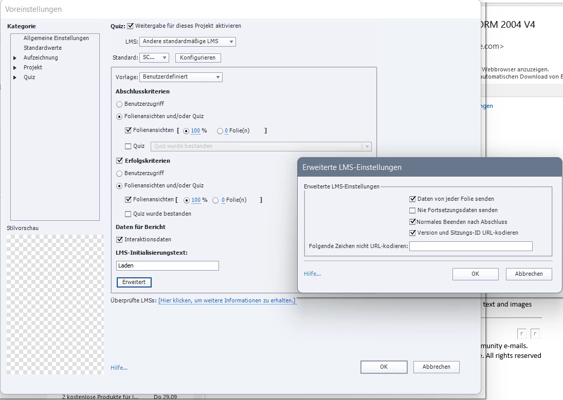

    perview-academy
    Oct 5, 2022 6:12 AM UTC
    my settings are as following (sorry the installation is in German):
    Even in Scormcloud debug log does not seem to report slide view progress - maybe I am wrong.
    https://app.cloud.scorm.com/sc/guest/ViewDebugLog?logId=4b3d240d-702b-46e5-abcf-40b908529a45&courseTitle=perview+E-Learning-Kurs
    Thanks for your appreciated help.
    RodWard
    Oct 4, 2022 2:27 PM UTC
    I think you may be misunderstanding what the Slide Views setting in the Quiz Reporting dialog is doing.
    Your subject line indicates you have set your module to report to SCORM 2004, correct?
    That means you are able to report Completion status and Pass/Fail status via separate variables  (With SCORM 1.2 there was only one variable available for this.)
    If you check the extra box for Slide Views, that means you are adding another criteria that will determine whether or not the module will be marked as Success. In the case I show below, the user would need to pass the quiz AND view all of the slides in the project otherwise their session would not be marked as Successful.
    Now, I suspect that you might have been expecting something different here, so can you elaborate on what exactly you were wanting to report to the LMS about slide progress?
