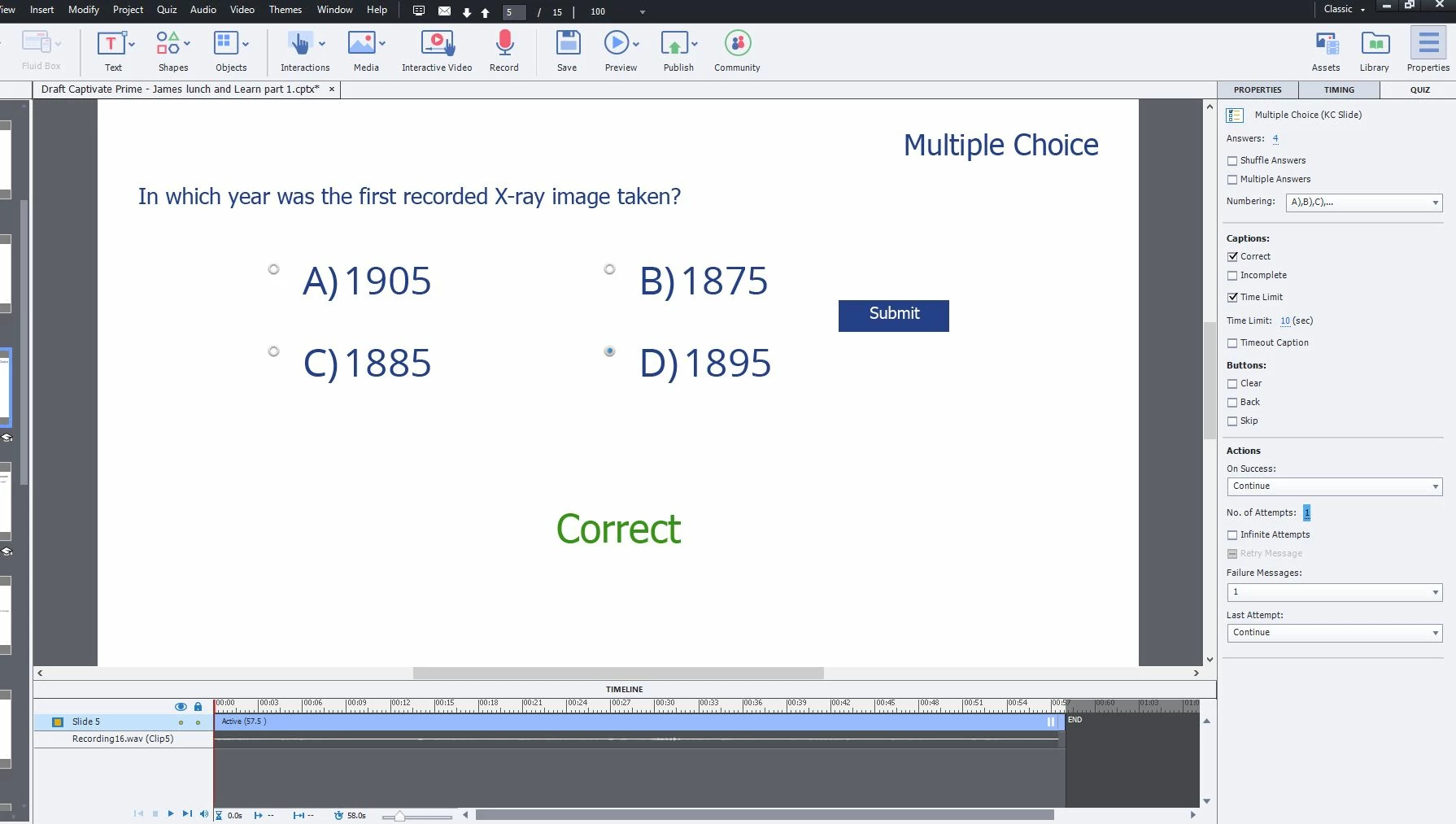

Nov 6, 2019 2:09 PM UTC
Thanks for your advice, I have tried to follow but without success. See snip below.
Any advice gratefully recieved.
Lilybiri
Nov 6, 2019 2:33 PM UTC
That image is so small that I cannot even see the pausing point. I do see that audio clip. Look at the slide timeline; name 'Slide 1'.  Probably at 1.5secs you 'll see a thin vertical line which is preceded by the pause symbol. Use the mouse to drag that pausng point almost till the end. When you Preview the quiz slide with F11 (HTML in Browser), the playhead will move till the pausing point while the audio is playing and stopping there. When you now submit the answer, and keep both actions Success and Last Attempt set to Continue, only the short part after the pausing point has to be passed. Did you look at that link? It is about understanding the Quizzing and the Timeline. You are new to Captivate?
