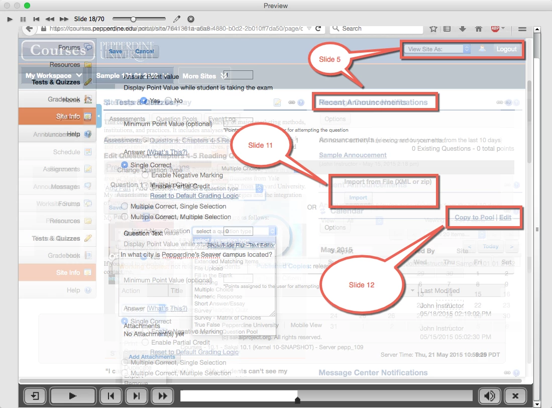

I'm experiencing a strange slide transition issue.
Essentially, I have set slide 18 in my project to transition with a fade.
Slide 17 --> Fade Transition --> Slide 18
When I click on slide 17 and then select "Preview" --> "From This Slide" it looks awesome. The transition from 17 to 18 is perfect.
However, when I select "Preview" --> "Project" and get to the Slide 17/18 transition, it shows a very strange fade. I paused the fade and took a screenshot. See the attached image below.
It looks almost as if it has stacked 3 arbitrary slides on top of each other (Slides 5, 11, and 12) and oddly shows them in the transition. I've tried copying and pasting the project into a new project. I've tried publishing the project as a SWF file (to see if it publishes that way). I've tried re-arranging the slide position, saving, then changing it back and saving. Nothing works.
Does anyone have any thoughts on this? Thank you!
    Correct answer johnb98198346
    Ok, I believe I found a solution.
    I tried copying slide 5, for example, pasted it in another project window, and then deleted the original slide in the original project. Then, I copied the slide I pasted into another project window and pasted it back into the original project. This did not work.
    My original approach was to address the slides that appeared to "stack" on the faded transition. But I did not attempt to work with the slide itself where the transition was actually applied. That was the key.
    I duplicated the slide that contained the transition, hid the original, and then when viewing the preview AND published SWF file, the behavior of a normal faded transition returned.
    I hope this helps anyone else who has run or will run into a similar thing!

    Erik Lord
    May 22, 2015
    What happens if...
    You make a copy of the project and delete the first, say, 10 slides, and the last slides after slide 18 or 19?
    You should certainly then not see anything from Slide 5, right?
    You've actually published this entire piece and you see this same thing in the result, right?
    What if you delete the odd slides (i.e. slide 5, 11, 12) - from a copy of the project - and publish?
    Do OTHER slides peep through now, or all is good?
    If all good, then maybe something...stuck about the slides you're seeing. Can you recreate them easily? (i.e. 5, 11, 12)

    Thank you both for replying. I failed to mention this in my original post, but I did, in fact, publish it as a SWF file and got the same result.
    I'll try some of the suggestions that Erik made and let you guys know. If anyone else has any other suggestions, I'm open to anything and everything!
