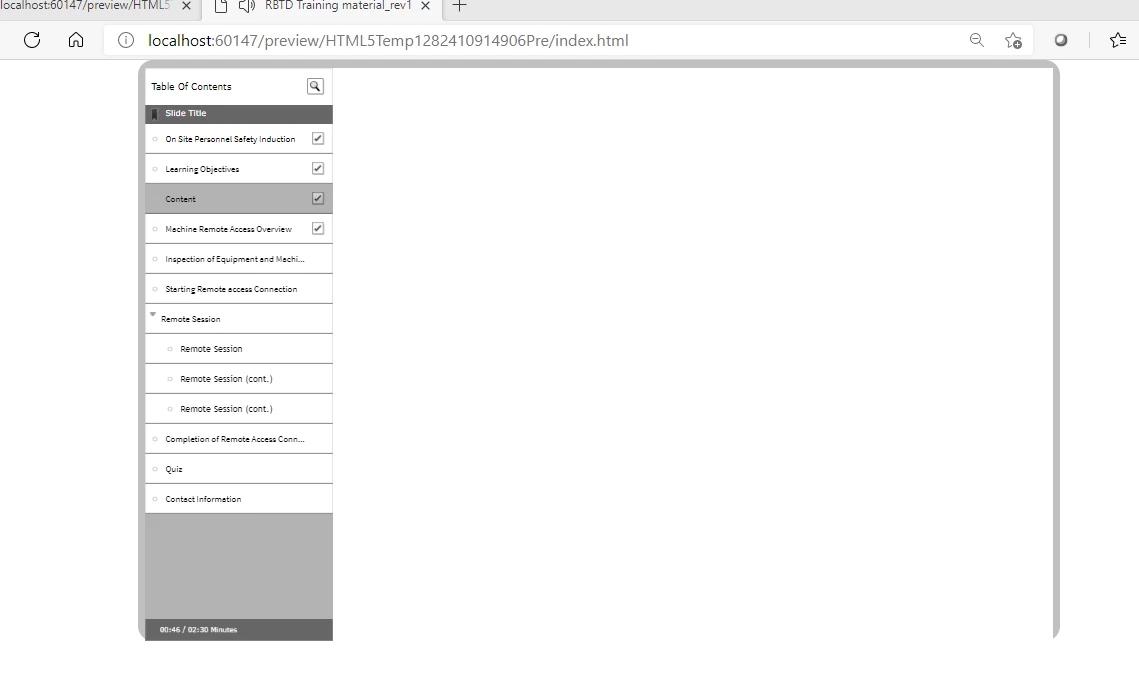

I'm a new captivate user. My project consist of importing pptx slides (company source materials) into captivate and working on them to create an elearning. I'm trying to create some form of forced navigation with a menu page (made from a blank ppt slide with objects used as buttons). Button actions are to execute a shared action.
My issue is when I preview the project in captivate it works fine. But when I preview on html5 in browser, this menu page with my objects as button becomes a blank white page. The playbar which is set to be shown also disappears. I'm not sure what I'm doing wrong here.

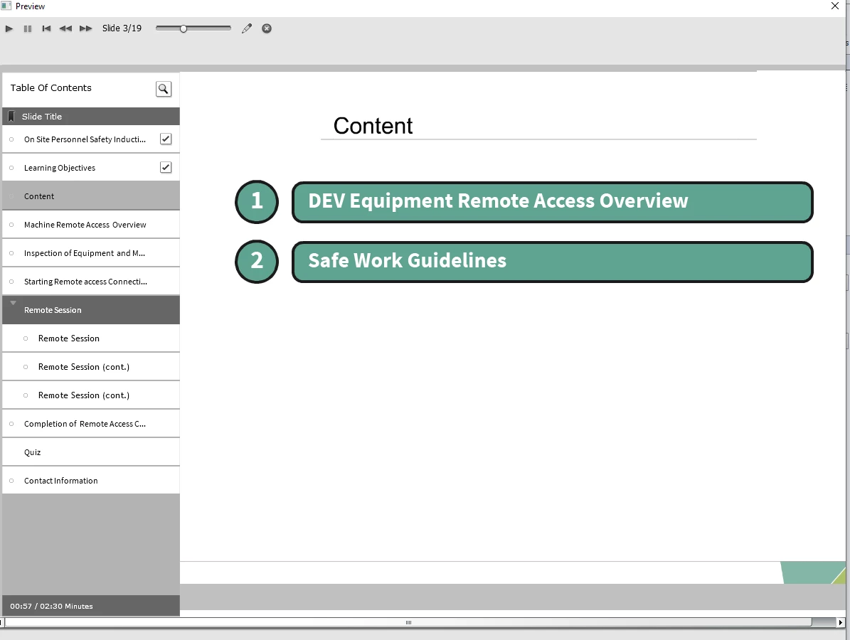

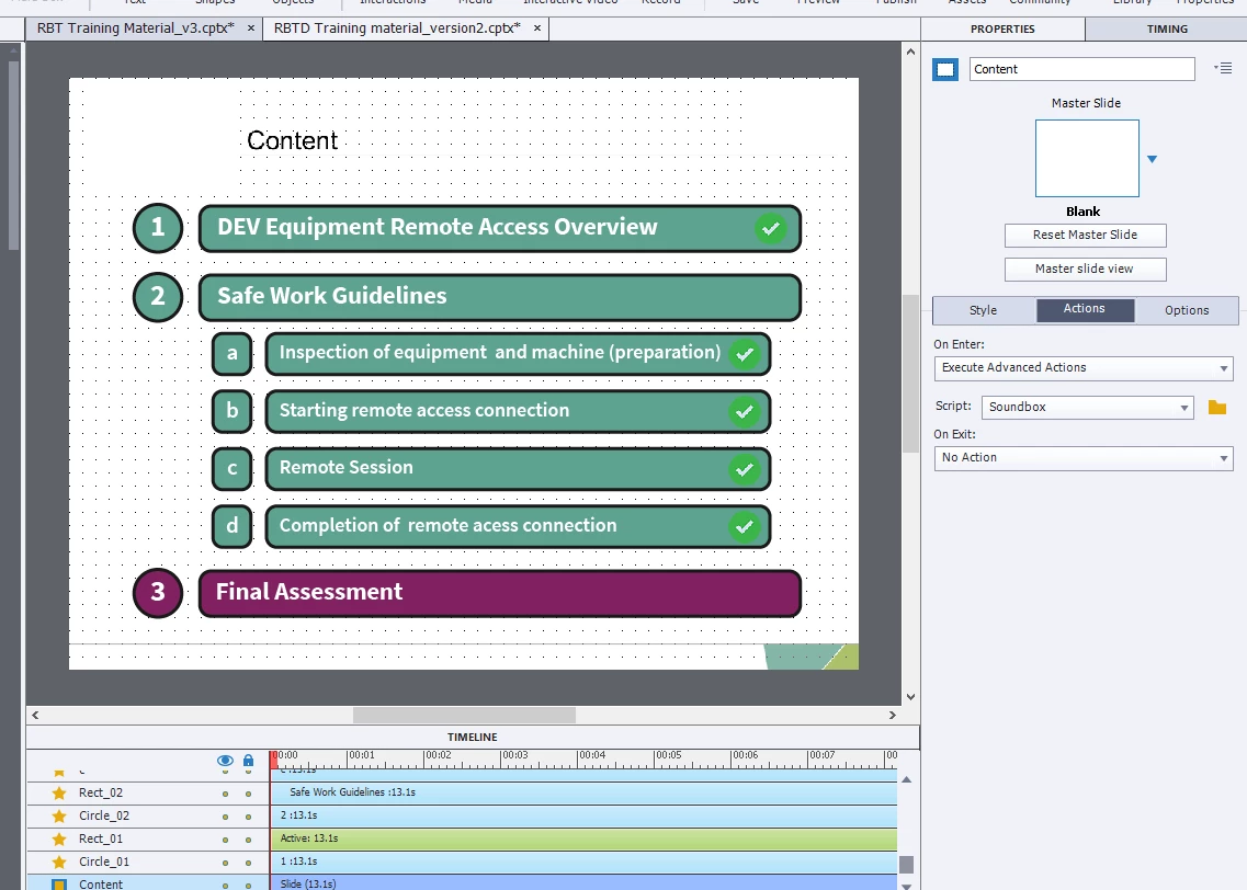

    To clarify, when I mentioned "preview the project in Captivate", under the preview button I select preview project. The issue I am facing now is that when previewing the project everything seems to work fine, however when I preview in HTML5 in browser there are discrepencies.
    I've attached some images to give a better explanation of what I'm facing. The first image is the captivate edit mode, as the user navigates through the elearning, they will return to this page when the other options are revealed. The second image is what I see when i preview the entire project (which is how i want it to go). The last image is the preview in html5 in browser where it is completely blank.

    Your first issue appears to me to indicate you may have a button or other interactive object on the slide and this is pausing the timeline before certain objects are due to appear.  However, I cannot see enough of the timeline layers in your screenshot to tell whether or not this is the case.   Edit mode will not show this issue up because the timeline does not pause in that view.  Check your layers and look for the pause point on any interactive objects to see whether this might be pausing the timeline before objects have had time to appear.
    Another possibility is that you have some of these objects set to be Not Visible in Output (hidden) and that is why they do not appear when viewing in HTML5 in the browser.  Have you perhaps been experimenting with using Hide and Show actions to reveal objects only after the learner has performed required actions?  If so, your logic may be the reason why things aren't working as you expect.
