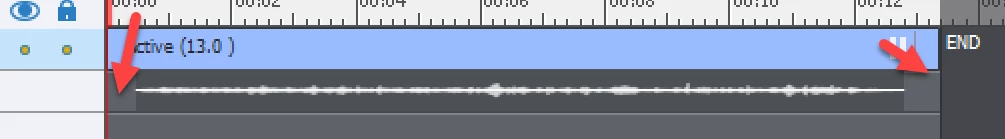

I have produced a software simulation over 300 slides and I have recorded a voice over attached to nearly every slide. I have saved the module as a zip file and have published it onto the LMS of choice at my place of work. But when I am playing the modules they are taking a long time to load, they keep pausing to load and the voice over is getting delayed. Can anyone think this might be, are the modules too large?

    Contrary to other assets, audio clips need to be loaded On Enter for each slide. They can indeed be very large, and you have a huge project. Try to leave a small gap before and after the audio timeline, that may help. I have explained the reasons exentsively in a blog post.

    Thank you for your reply, I will try that today. All of my audios are recorded onto the text caption that they apply to so there is gap at the beginning but I shall add a gap at the end as well and see if that helps. Do you think becasue I have recorded them to the text caption that would have any affect on the performance?

    Oh... it is not slide audio, in that case this trick is not applying, unless te text captions to whih you added object audio start on the first frame.
