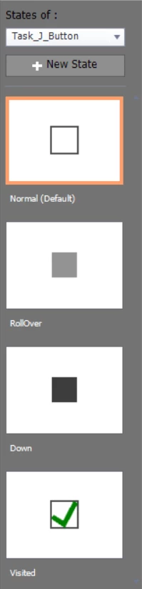

Can you post a screenshot of the Object State panel? Since you talk about 'Visited' state, if you point to the InBuilt states, I presume that you are using CP2017, can you confirm, please?

Here is the Object State Panel.

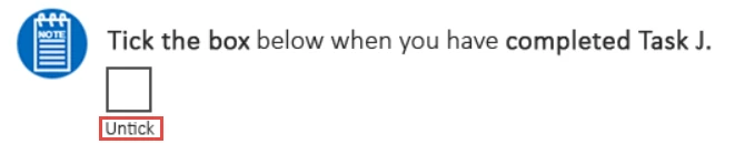

Here is a screenshot of it on the slide it's the square box. I've also highlighted an Untick shape button. This has the same problem, you have to position the mouse pointer right at the bottom, literally on what must be the border of the shape, to get it to perform the action.
Do you think the rescaling could be causing a problem? Although I anticipate the course will be used mainly on laptops or tablets.
