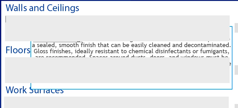

Good afternoon,
Working on a course with text entry boxes and using a Smart Shape as a feedback caption that's supposed to come up on top of the text entry box. However, even though it's on the appropriate place on the timeline, the text entry boxes keep coming up on top of the Smart Shape. I've also tried using a Text Caption and get the same result. Any ideas what could be causing this? Pics are below. I'm using Captivate 10/2017 and the Smart Shape shown below is at the top in the timeline. It previews correctly in Captivate, but in HTML5 preview and output shows how you see it below. Thanks in advance for any help!

Text Entry Box will always be at the top of the stack in HTML output, probably because it needs to have the focus. Changing the layer stack order in the Timeline will not change that. It is similar to the priority of embedded quiz objects on a question slide: they always are on top of the stack.
I suppose JS could change the z-index, but I never found a workaround for HTML output in Captivate itself. For SWF output lot of workarounds were possilble (I put the shape on a short slide before the present slide, timed for the rest of the project and it did show on top of quizzing objects or TEB's).

Dec 17, 2018 2:13 PM UTC
Thanks! I thought so, but was hoping there was another way.

Based on your design I would think that you have a hidden smart shape or text box that you show based on the text box and an action you created.
Text boxes have their own success / failure / hint as part of the object but that is not what you are talking about.
As I recall, when you create output in flash their was no Z order implied in the compiled file. But that is not the case in html5. So what happening is that when the slide renders in html5 it is placing the text entry box at the highest level in the html5 Z order (stacking order by default) so it will always be on top. You may have to move the hidden object or your response to a different location on the slide.
If any others have info on Z stacking order in how Captivate will render html5, would be appreciated.
