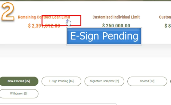

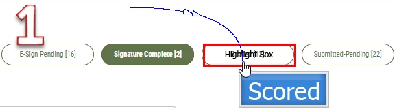

    Captivate 2019  version 11.8.0.586. I've included a couple screen shots below.
    1. What it looks like in editing (.cpx) in Captivate (correct position)
    2. Pulished version with misalignment.
    Lilybiri

    Was the highlight box added manually or using the setup for software sims?
    You are using the most recent version, necessary for Win11, M1chip and Monterey. You are not the first to mention problems with that version. The misalignment is very clear.
    Preview HTML in Browser will not show as rescalable, so that is probably not the cause.
