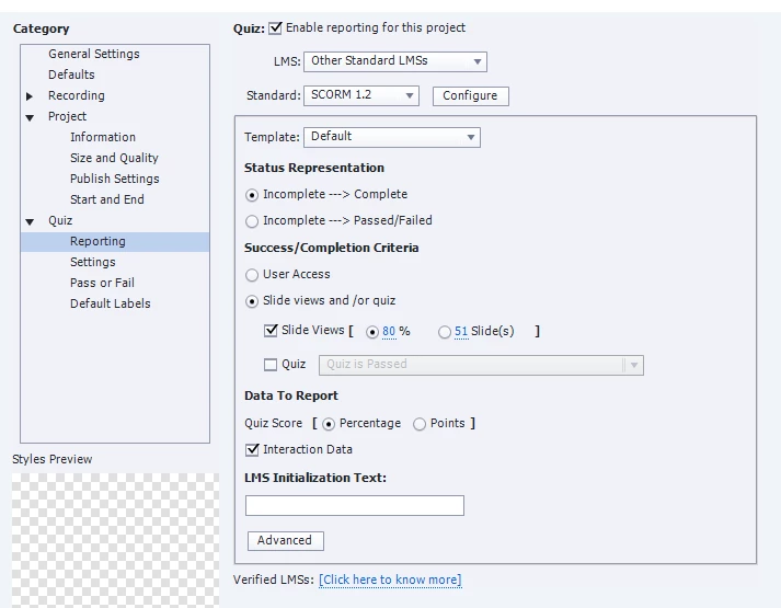

I have a Captivate compliance course that is marking "complete" for most of my test-user population, however, not for others - specifically a Chrome user. There is not a quiz in this ecourse, so I used the "incomplete->complete" settings, with completion set to 80% Slide Views. The LMS being used is SAP SuccessFactors. The several other users did not have any issues.

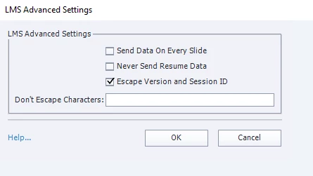

I've included my publish settings below.

Some LMSs don't act always corrrectly if you don't have any score. Is the click on the Exit button mandatory? If yes, just put a score to it, and require that score as passing score.
