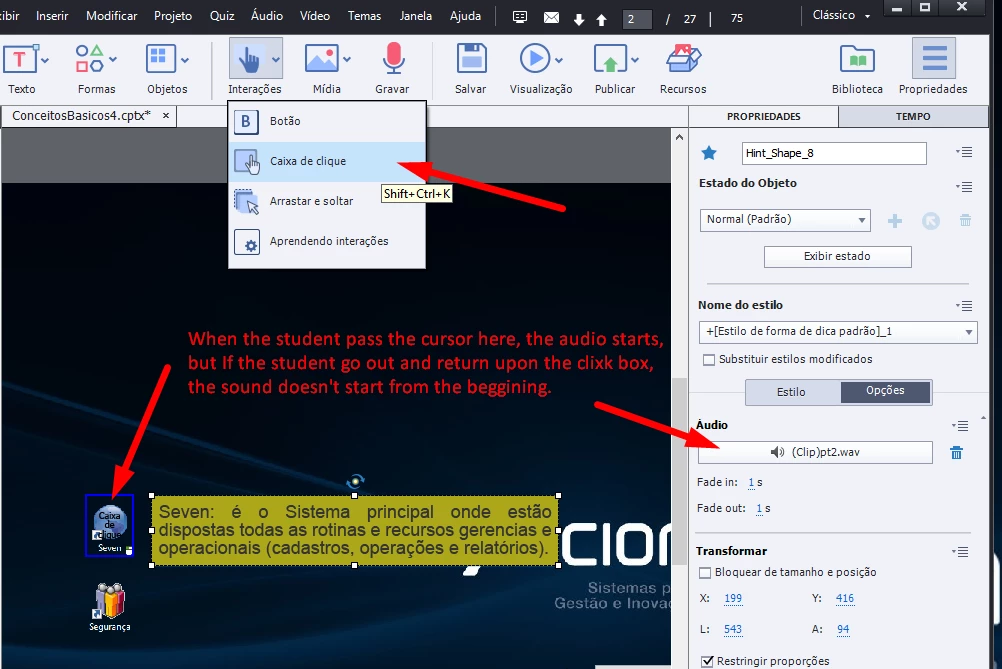

I use software simulation tutorial and I added a resource that when the student pass the mouse cursor upon an icon, this act releases a sound (voice narration).
The problem is when the student moves out the cursor, the sound stop and when the student back the cursor upon the icon, the sound starts at the same point it stoped earlier.
I would like to work like this:
When the student moves the cursor upon the icon, the sound starts, when he moves out, the sound stops. If the student moves upon the icon again, the sound starts from the beginning. Actually when the student moves upon the icon again, the sound starts at the same point it stopped earlier.
When I use to view the project "next 5 slides" it works as I want, but when I publish it, it doesn't work correctly.
How can I solve this problem?
