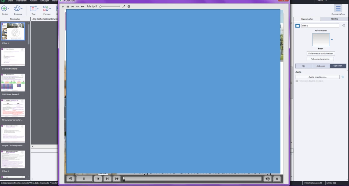

Wie kann man in einem Projekt die Weiter-klicken-Funktion für z.B. 5 sek. deaktivieren? Hintergrund ist, dass ein Teilnehmer einer Unterweisung sich nicht durch die ganzen Folien durchlicken darf.

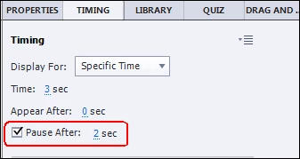

    Each 'click function' as you call it is linked to an interactive object: click box, button, shape button, (Text Entry Box). There is a default pausing point (mostly set at 1.5secs from the start of its timeline). Is it that what you want to change? You can apply the change to all objects of same type (like all click boxes) using the small menu top right of Timing.

    I cannot see the Pause After Function...
    I only see the specific time dropdown, the time in sec. and appear after sec.
    But you can see the Play/Pause Button, the Back Button, the Next Button etc.
    How can I lock the Next Button maybe for 5 sec.?

    OK, you are not talking about an interactive object but about the playbar buttons. Unless you hire a programmer you cannot control the playbar buttons, you'll have to accept them as they are. That means that none of those buttons can be locked down for a certain duration. Sorry. This is only possible if you create custom navigation buttons.
