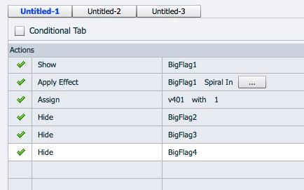

    I did not duplicate... I did create 3 other sets of actions to work for each flag that is clicked on...   None of my butons have a pausing point... I will have a conditional set of actions that will show a "Next" button once each variable equals 1.
    I just cant figure out how, or if it is even possible, to move the location of where the Spiral effect begins so I can make it look like it spirals out of the appropriate flag.

    How do you start the effect: with an advanced or shared action?
    March 28, 2018
    I have it in the advance action...

    I have a meeting now, will be back. Need more information: you did duplicate that advanced action and edited it?  The buttons triggering those actions have a pausing point at the same time?
