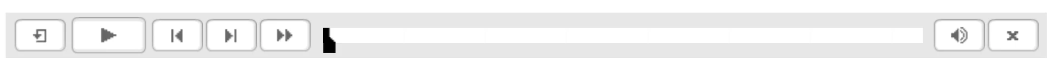

    Your first question: I suspect you mean the 'pllaybar' whan you talk about a Master playbar?
    The screenshot shows that playbar ar the start of a course. Autoplay is disabled  since CP2017. Hence the play button, which also appears in a big version in the middle of the start screen. But on slides the playbar NEVER pauses the timeline at all. This means that you do have not only the playbar but probably some interactive objects on the slides. I would like to see the TImeline panel for one of your slides.

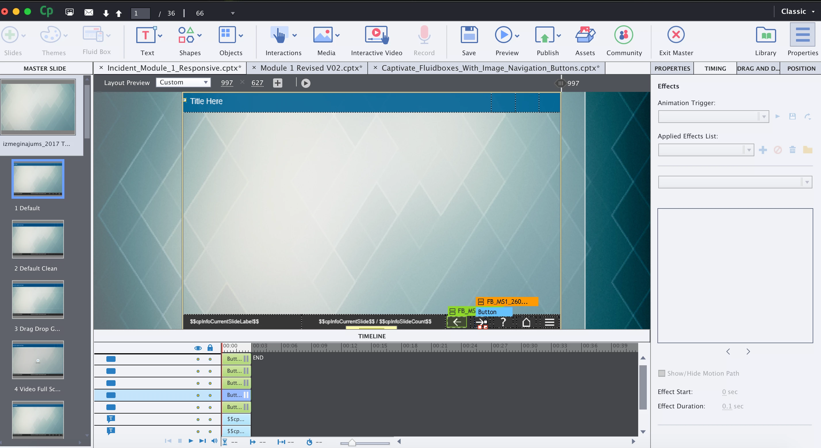

    I am using Light Fluid Boxes Theme from 'FasterCourse'. The Playbar is therefore not default. The buttons are set up within the Master slide - which is where my reference to 'Master' and 'Playbar' came from.
    I absolutely opened the timeline as one of the first things to check and did locate the pause options against the buttons. I also checked the Timing tab but there were no options available. Hence the question and my subsequent action to move those buttons into the actual slide so I have control over their duration.
    The issue, I therefore experience, is that any slides of any duration - e.g. animations and narration over 30 seconds - stop at 3 seconds due to the button pauses that i seem to have no control over - whilst editing the Master Slide... Whilst this makes sense (how could the Master slide ever possibly the length of every slide that uses it...) it did lead me to the only conclusion being to remove those buttons from the Master slide and place them in each slide I create - thereby giving me control of where the pause occurs.
    Here's copy of my screen.
    Thanks again.
